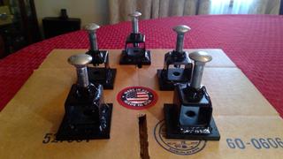

I do as Steve and Chuck suggested first, then if that fails I have a tool made by a member here that I use. Here is a version of that tool offered for sale by another member
viewtopic.php?p=775630&hilit=Cap+tool#p775630

Hi I have a tool to remove the screw from the three-piece cap look for my post in classified and PM me to order one
