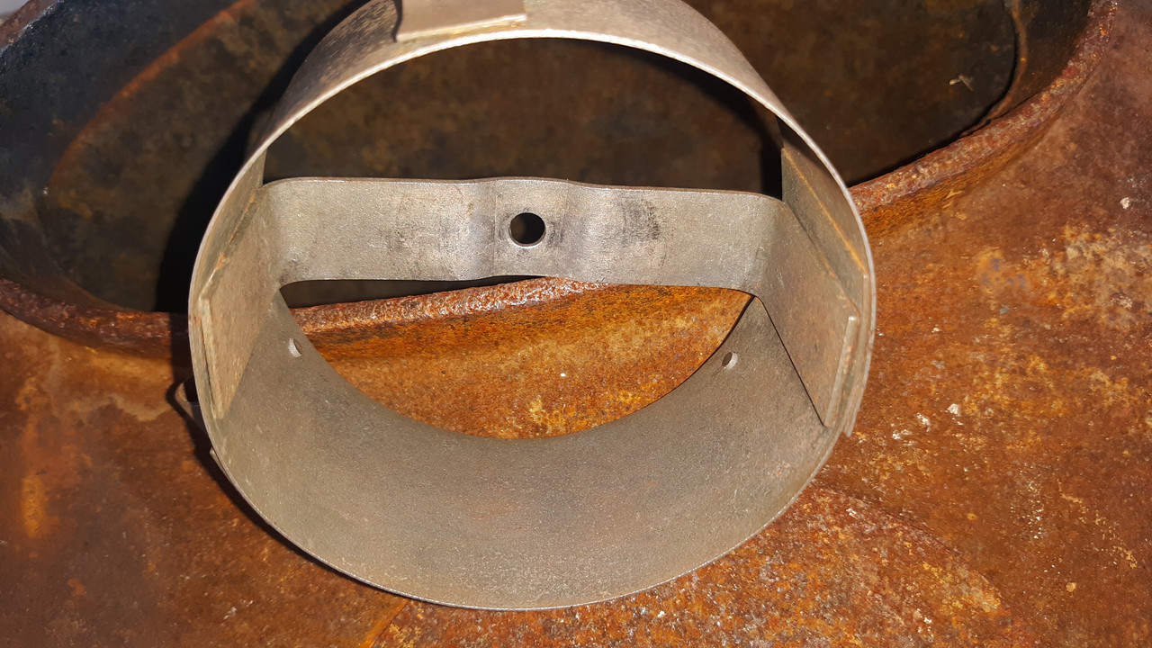

here is one of Davids pics :-) is it brass ? or painted steel ? we have been trying to find some good pics like these to see if we can have a few made up :-) these shades are pretty heavy and need that extra support ring . i had also read something about an asbestos gasket on top of that support , between the shade n the support ? im tickled to get some good pics like these .

It's a fairly soft metal. Able to bend with fingers.

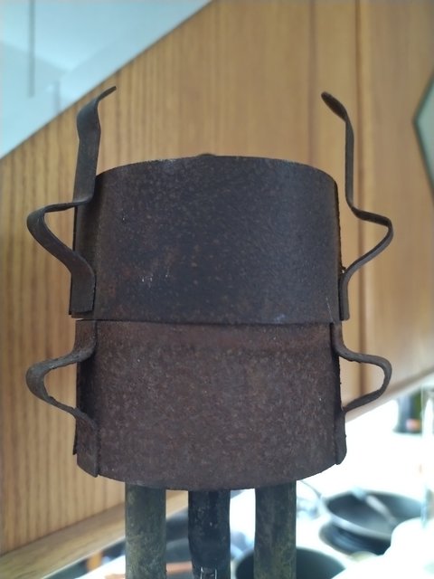

here is what im thinking about . one might be fine but two might be better . but still , doesnt look to easy :-) these are steel and would need to be hit from the inside n support the head on the outside to look best . so im still just in the thinking stage .
Last edited by SteveRetherford on Sun Jun 05, 2022 8:45 pm, edited 1 time in total.
Posts: 10604
Re: Deluxe Quicklite Lamp
if i just push the arms in they dont touch flush and will need a bit of adjusting . looking at yours here i can kinda see some extra little bend on those arms of yours at the elbow ? subtle but i can see it . thinking thats how they got em to sit flush ?

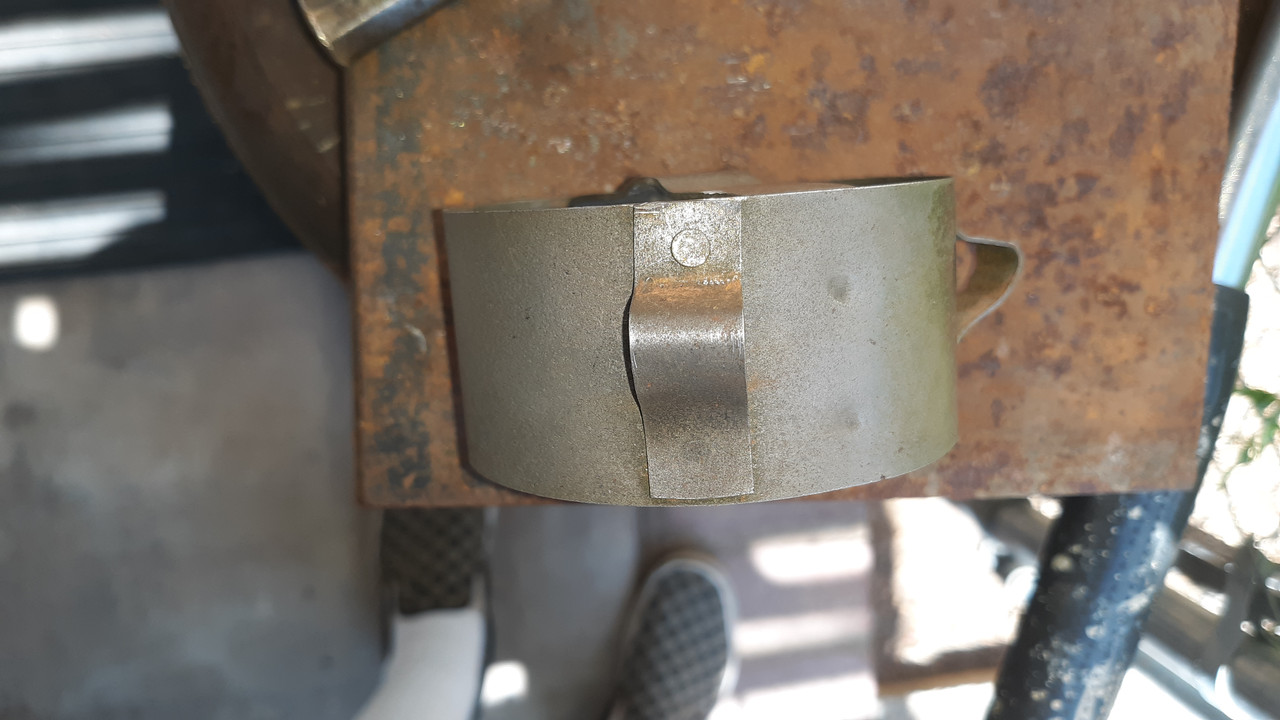

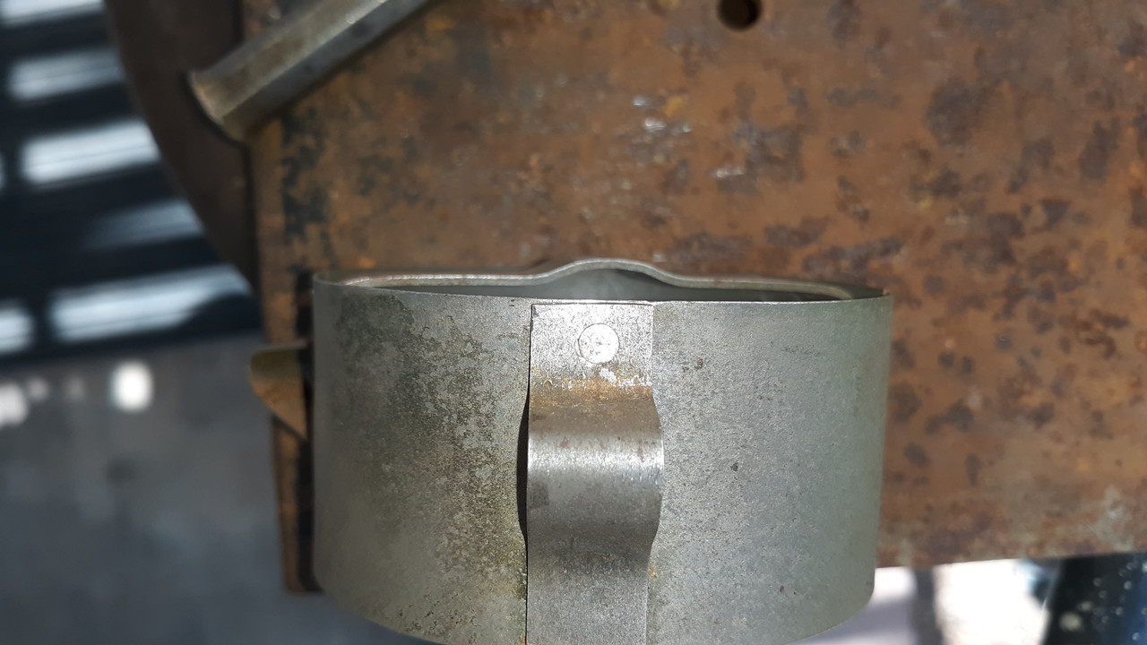

here is my backwoods type MODIFICATION for the shade holder . took me an hour or two but looks pretty presentable to me ???? if only i could spot-weld that would been much faster !!! but my hopes was that my FIX looks PERIOD CORRECT for a repair , couldn't use hollow aluminum pop rivets and i just happened to have a few of these tiny size HAMMER IN steel rivets , they really pretty UN NOTICEABLE to the eye . the repair doesn't jump out at me ?
i have a pretty good BIG mess of tools on the back porch to clean up now for such a small job .
Posts: 3522
That sure looks like it'll work Steve. I had to zoom in to see the rivet. :D

OK i have to give Patty some credit here as i could not hold the shade holder the hammer and the punch with just two hands ..... " no not like that !!! i might hit your fingers with the hammer " . after the first whack she held her fingers WAY WAY back LOL :-)
Posts: 9744
Awesome job Steve...and Patty!
Posts: 10604
someone commented on how nice i flattened the rivet , but that out side portion was already flat to start with , i whacked these from the inside , took like 3 whacks on each to get em how i like . it was not easy cuz you cant swing a hammer inside a shade holder so i had to get creative with my punch layed on its side , i whacked on the punch outside the shade holder but it crushed on the inside . pretty darn happy how this came out .

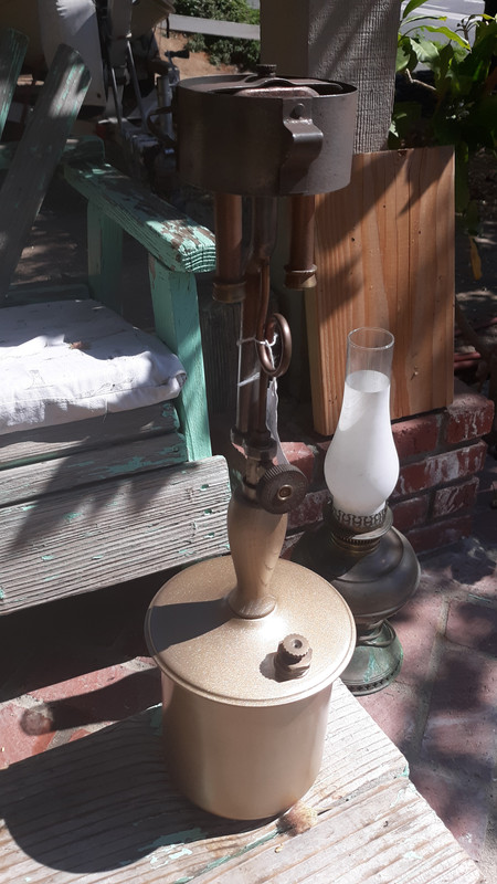

got a can of rustoleum gold spray paint for the fount but on the way home im not so happy with the color , its metallic ( they all were ) so sorta has a little sparkle to it . the fount is bare brass now and you practically see every finger print that has touched it , its tarnishing well LOL the paint is to prevent that .

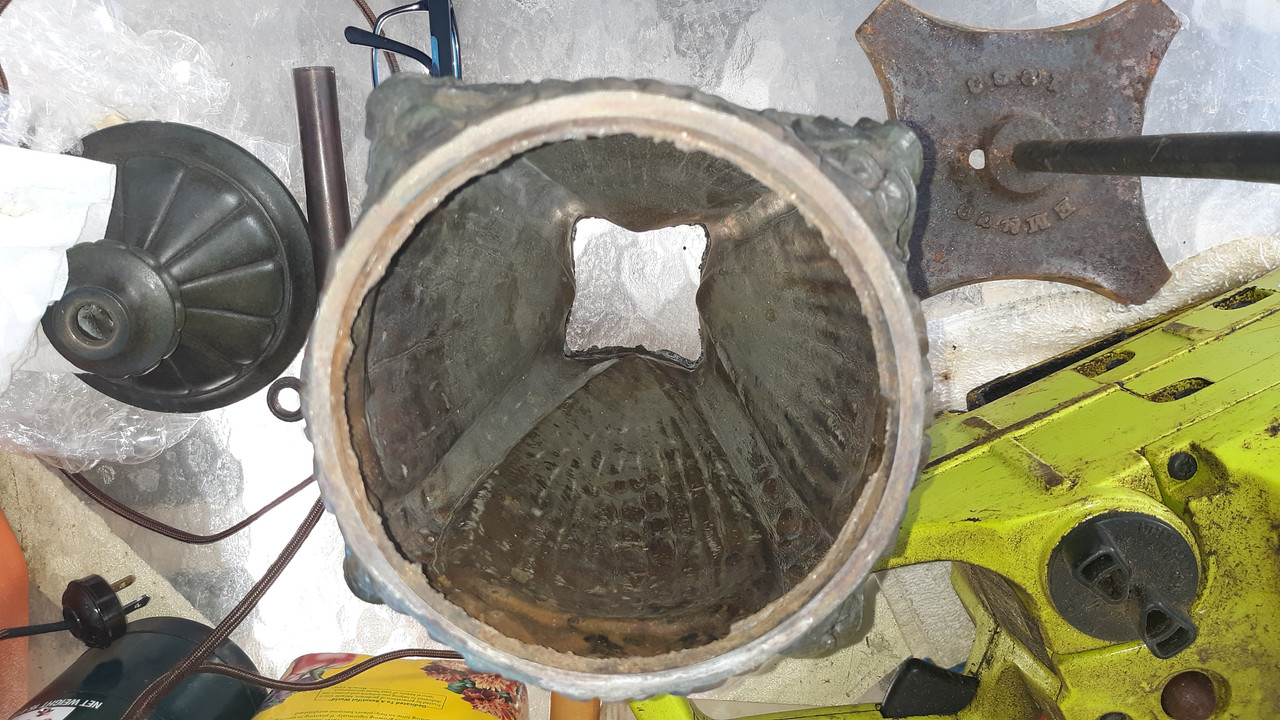

but when i look at the pic of inside the VASE above it looks pretty close . its hard to match nearly 100 year old paint .
update > its drying , in the shade it looks real good , in the sun it has some sparkle .... i was im patient :-)
im afraid i may have to re do it , the paint doesnt seem to be fuel proof , i keep testing an experimental piece with coleman fuel on a rag and it starts coming off , have to let it really cure n re test ..... or might have to put a clear enamel over it in 48 hours , well see .
Posts: 10604
in the shade it looks OK but in the sunshine it has sparkles i don't like , i think i found a color on line Vintage Gold i like better . so il likely re do it . Buckeyecamper David is gona send some detailed measurements for the support ring next :-)

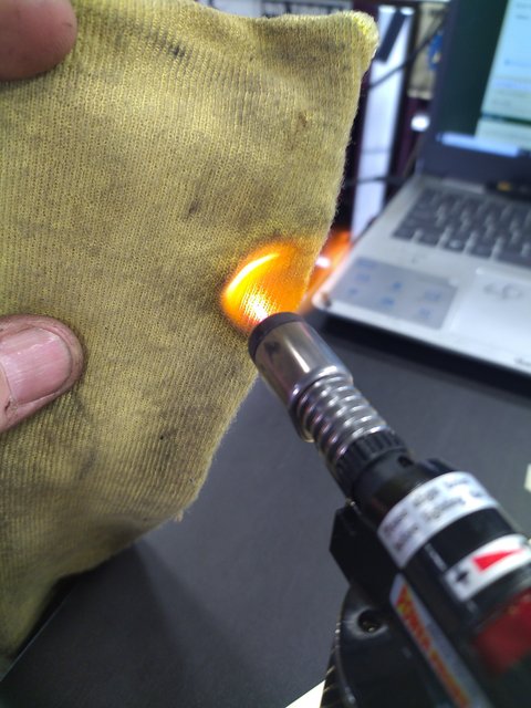

Here's an idea Steve. Nomex. It'll scorch and turn to ash with direct flame, but not without an oxygen supply and more than 600°
USGI surplus stuff like this is yellow. You can probably find some to test.

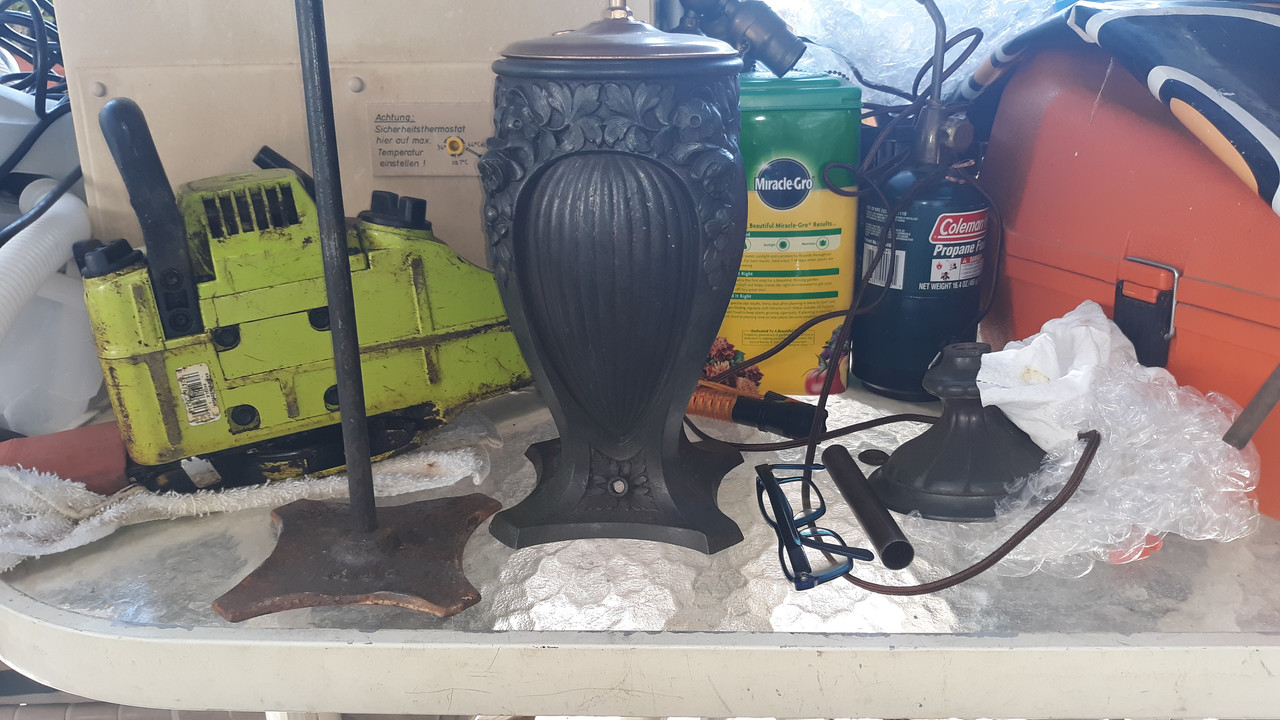

OK i got brave n took apart the electric lamp , i was kinda nervous not knowing anything here , but it was pretty simple . saw a few parts i wasent sure about . so im curious Dave , does yours also have this nice machined metal ring that fits on top of the vase ? . without this ring its a rather rough casting . so i go get the fount and it fits the ring perfectly and drops right in :-) was pretty happy just seeing it get to this point ...... the bottom is rather ugly , like it needs felt !!! there is a steel foot that held up the electrical parts , all i have ever really seen are some complete lamps sitting up so this is all new to me diving into this , but its looking pretty rewarding :-)
