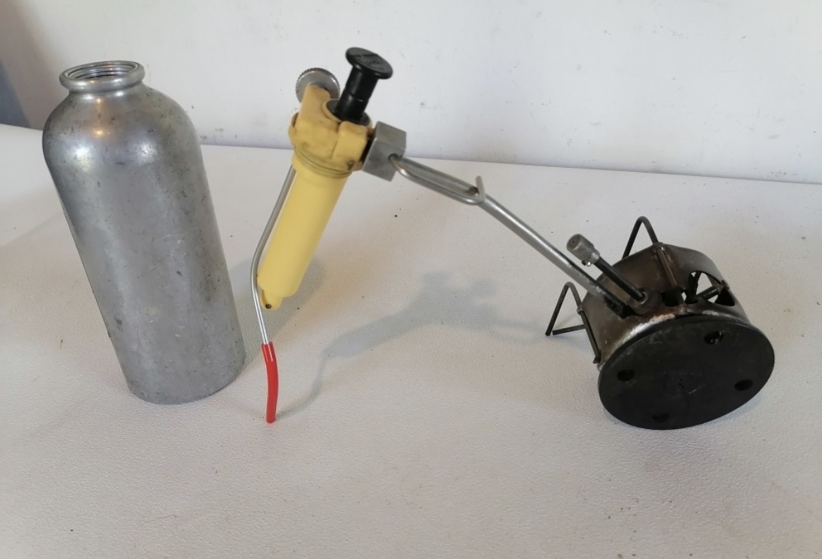

I am well aware this is NOT a stove place but anyways I’ll ask this. I need you guys to help ID this stove before I go ahead and get it, I’m not a MSR fan but this seems like an old one.
Those are the only pictures seller sent me

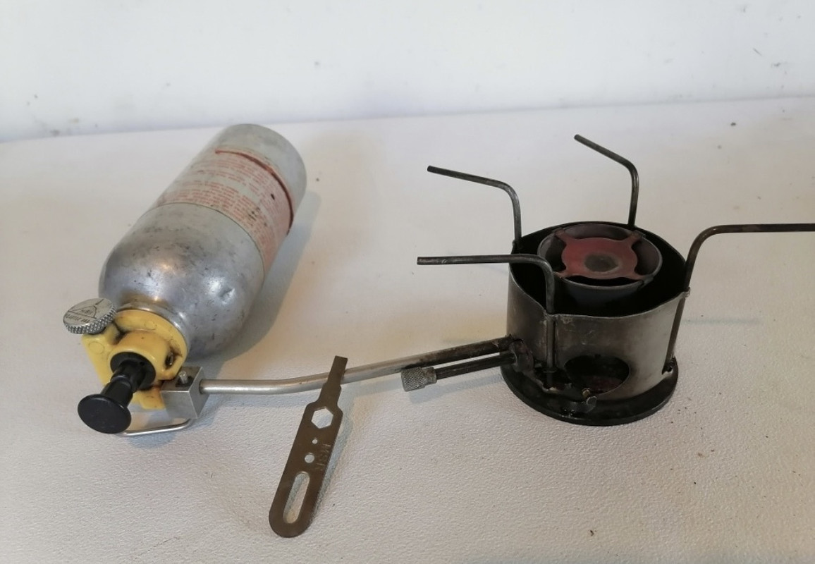

Looks like a very early model G, gasoline only. Bakelite base (they didn't last), no generator over the top like a GK, yellow pump. I'd guess mid-'70s? Aluminum fuel siphon is different from any MSR I have, too. Send those pics to MSR and maybe get an answer.

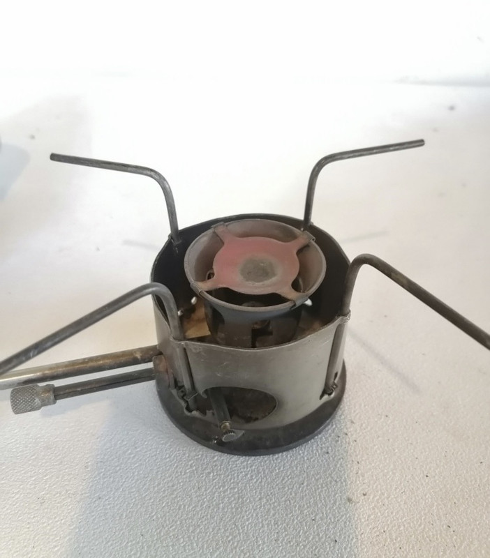

Thanks y’all, I’ve found a small damage in the burner cage

I’m not sure that’s damage. I’ve flipped a few of these early Model 9s. You’ve got early parts including the Sigg bottle with the MSR safety label, early pump and the simmer plate that looks like the top to a can of tomatoes. Missing the tin cup that the stove sits in. Look closely at this pic from the MSR gear history. The burner was cut to allow the striker to move in and out. It might need some adjustment but I don’t think it is “damage.” Although I would defer to Duane as the expert on these.

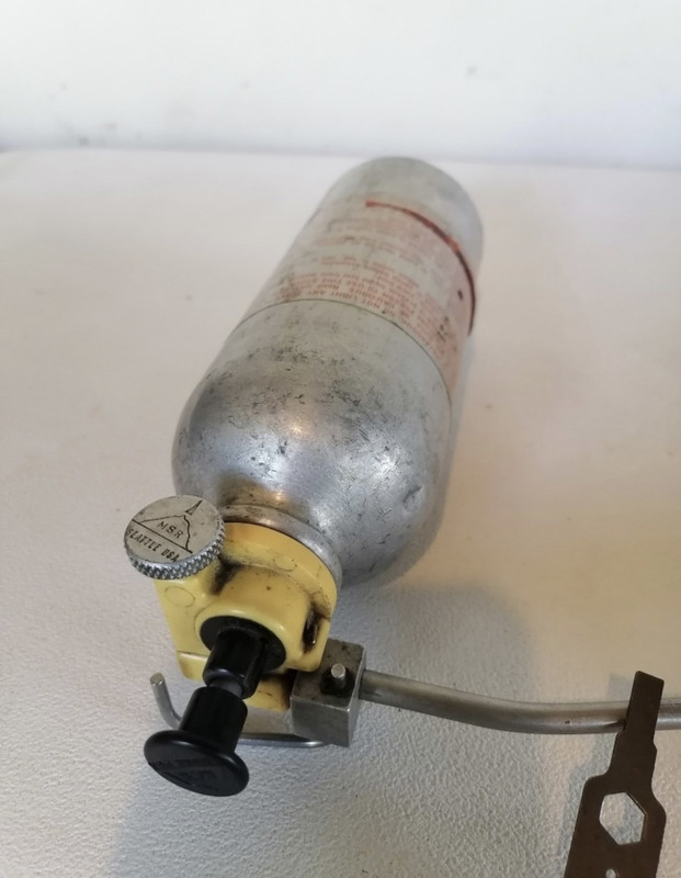

Nice stove . I think it is a Model G- gas only. The G I had was the same color and had a small cotter pin thru a hole in the bottom of the burner bell , which was supposed to help let fuel drip down to the priming pad to help with preheat. The one pic that shows two stoves , you notice the scalloped burner bell on the left stove which looks to be early model 9 ?, the blue one has a flatter generator loop which was either "Dual" fuel or Multi fuel Models. I own the silver one in the other pics that is near the same as Pancho's,but with the added generator loop, which is a G-K- model -Gas-Kerosene The stove body is cut out by the sparker to be able to remove it for service. Once removed, the hard pipe fuel line is turned to the right thru the notch to remove the burner bell/fuel line from the pan wires /base. The Sigg fuel bottle was the standard used with the safety label, before MSR made their own. I think the yellow pumps changed slightly in the years they were produced. Great old proven classic mountain stove. Fun stoves to run, Post some pics when you get it running. Just my 2 cents.

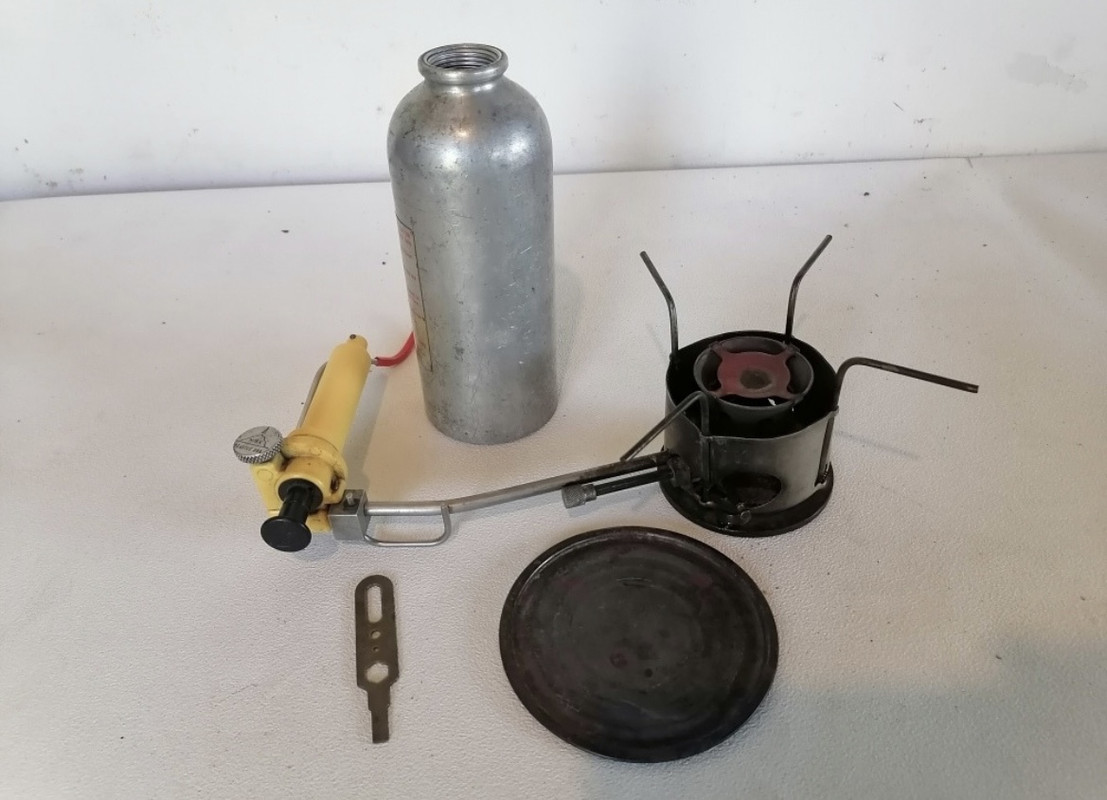

It’s here

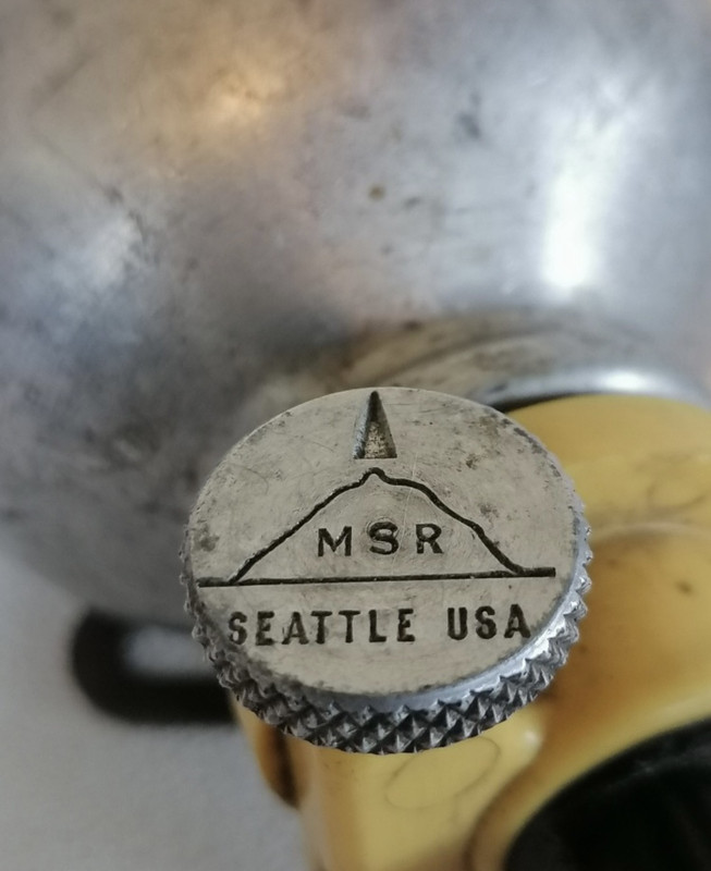

I need a picture of the fuel line and especially the block where the fuel line connects to the pump. If it has a date stamp, that's where it will be.
From the Bakelite, base, it's early, because, as you can see, the Bakelite base falls apart after some use. Another part MSR replaced on my early GK--even if they deny it, they did it.
Posts: 3800
Re: MSR ID
Gunhippie wrote: Fri Nov 04, 2022 2:26 am I need a picture of the fuel line and especially the block where the fuel line connects to the pump. If it has a date stamp, that's where it will be.
I see no dates or anything

I'm a little late to this, the Notch is not damage, I'll find pics of my early Model G and post. ** edited ** Hmm, no pics, I'll drag it off shelf for pics, and Yellow Pumps are pretty rare these days!

And the thing that looks like a can lid is an original early MSR simmer plate.
Keep it with the stove!

Yes! And originally had a metal cup, aluminum windscreen/heat concentrator, and two different diameter aluminum base plates. The tool shown is from a maintenance kit.
Posts: 477
Re: MSR ID
Pretty sure it’s a 9A. The first model 9s had a masonite base. There’s a ton of info on CCS. Start here.
https://classiccampstoves.com/threads/m ... lug.22178/
